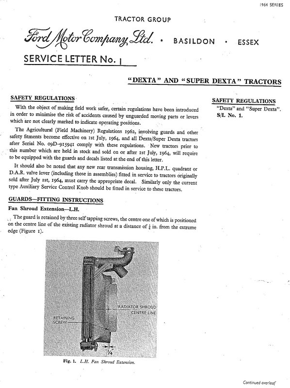

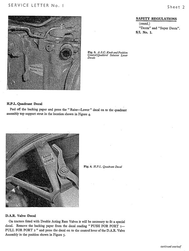

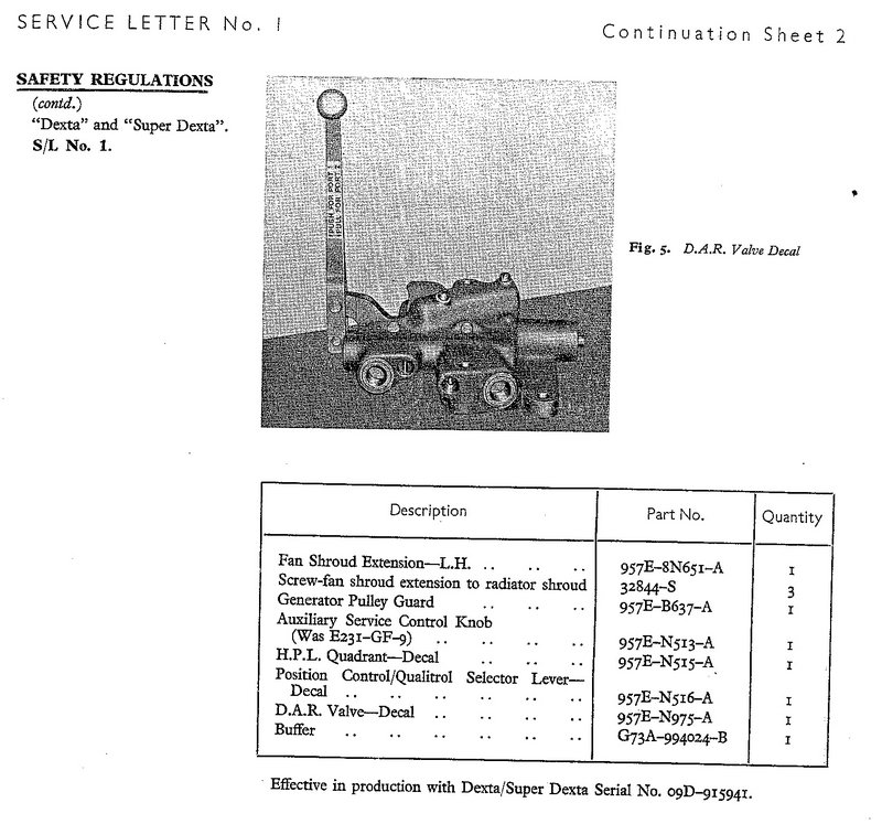

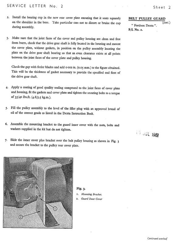

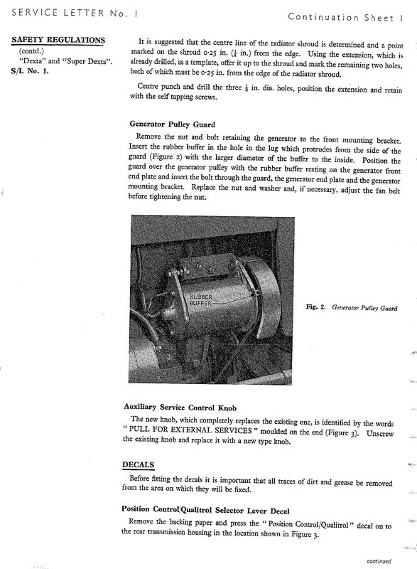

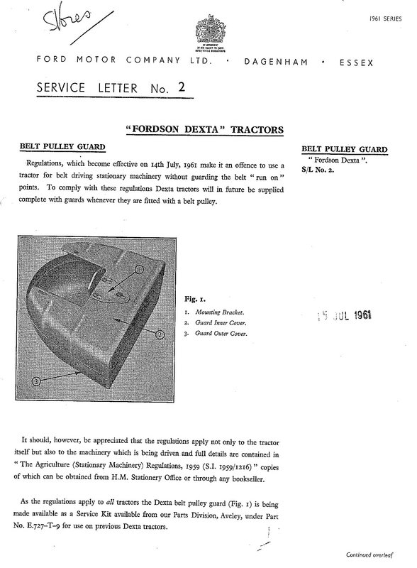

In 1964 there were some things added by regulations too, I'll post the service letters tomorrow.
Posts: 2501
Re: Looking for a new or used atomizer
Sorry for the delay, here are the service letters I have:
