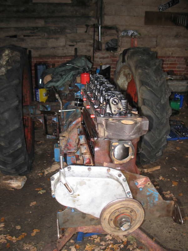

I'm working outside for the dirty work. This stage is just getting all the muck out and cleaning it with degreaser and water.oehrick wrote:I've taken recessed square socket plugs out using a socket drive bar Mathius and either shimming the gap with bits of steel (usually secured to the socket bar with wire or tie wraps) or making box section collar to fill the gap, sometimes I've been lucky and found a bit of square steel the right size or near enough to grind to fit then drive that with a socket.
You are making good progress, do you have to work on it outdoors like me or does it come out for photo's and dirty work ?

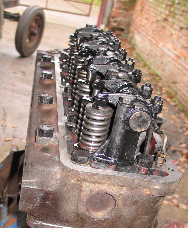

Hope you won't mind me saying that what I see in the photos is not the required level of cleanliness. Well, clean is an absolute, to be pedantic, so there is only one level! You must remove everything from the block, then set about rendering everything spotless.
To remove the longitudinal oil gallery plugs I took an old 1/2 inch socket drive and ground it down to fit the square. You'll use it twice and then never again!
You need to remove that oil pressure gauge sender and the blanking plug above. Water jacket drain tap also.
Degrease everything, then go to work with the wire brushes attached to an electric drill. The face that mates with the mounting plate needs to be shiny clean ready to accept a coating of Wellseal and the gasket; likewise the mounting plate.
Still can't see the bottom liner seal grooves clearly. Are they eroded? This is a key issue, so I would be keen to know that the grooves are intact and able to hold the new O ring seals. The grooves should be cleaned with the electric drill wire brush mentioned already.
Clean longitudinal and lateral (lateral = from oil gauge sender aperture to oil filter housing aperture) oil galleries with pull-through and/or rifle barrel rod cleaning kit.
Don't be satisfied until everything is spotless! [See my photos above - I had no workshop, but it still can and must be done.]
