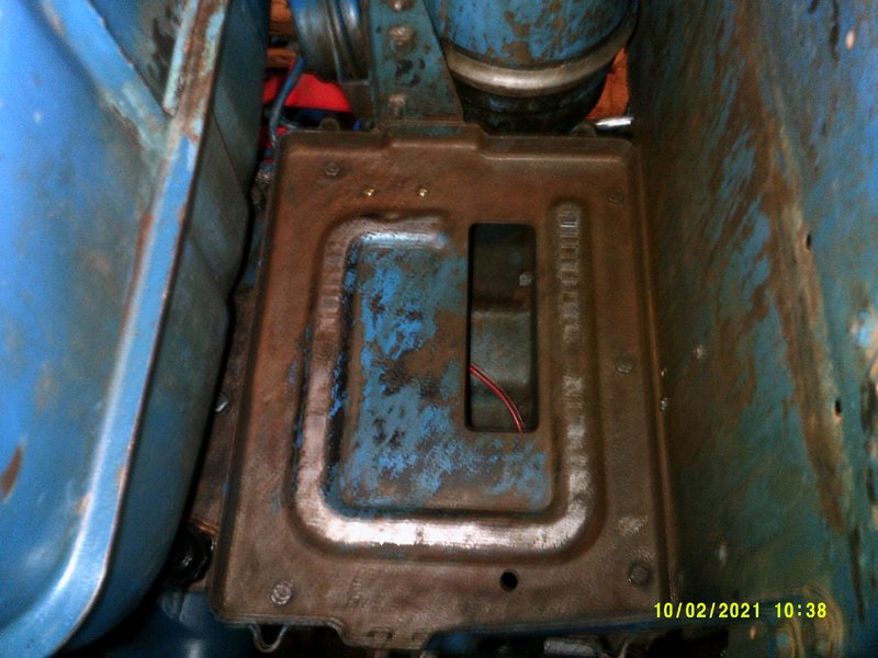

Getting some new front tires and finishing painting axels. Then new photos before replacing bonnet. Quick question. Can’t seem to find the original location to secure starter solenoid. Can I have a few pics of where you guys have yours in relation to air filter and fuel tank. Thanks.

The solenoid is fixed under the battery tray (Billy's one here), with these brass screws.
Note the rubber cover on the battery lead made from an old inner tube (there was a cover like that originally).

Thank you, I had seen those holes but thought the clearance looked tight and was worried about shorting, will have to make sure well insulated......

Don't insulate those holes, or the solenoid will not have an earth and it won't work.
