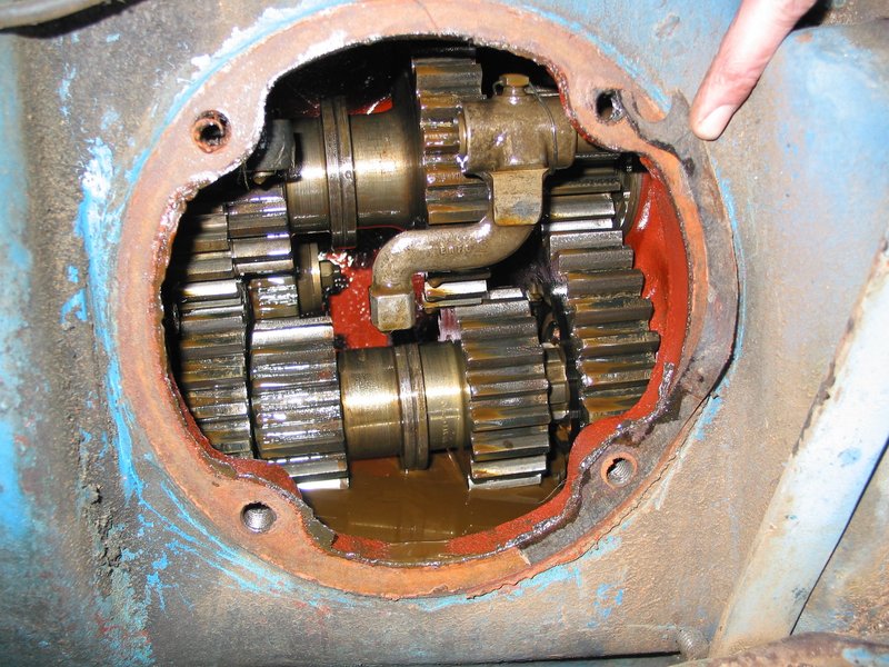

Have found that, having removed the side plate that holds the selctors, the box was in 2 gears at same time.
Removed side plate again but not sure which selector goes where.
Replaced seal in pto box, things moving on slowly!
Posts: 2559
Re: live grive gearbox
Have you checked you can't get it in two gears at once again? This should save future problems. As for the location of the selectors, put the recessed part in line with the raised portion of the gears, it will be easier to move the gears, make quite sure they're in contact with each other.

On a slightly different note I have dismantled the pto gearbox today. It's obviously been apart before because the selector has been assembled the wrong way around meaning that the gears were always engaged when the PTO was supposed to be disengaged. Took it apart, turned the selector round on its shaft, tightened the securing pin and works perfectly.
Tomorrow's job is to sort the main gearbox selectors into their proper position and make gaskets for all the castings and reassemble.

At last with the help of a friend I have got the gear selectors in the proper order and the plate bolted back in place.
The PTO gearbox is also fixed and now runs out of permanent engagement
