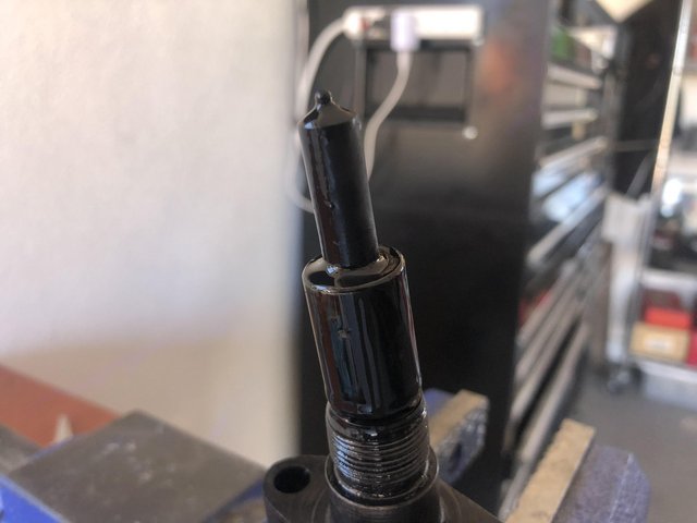

The reason im asking about seals for the injectors is because I found engine oil all over them when I took them out. Im new to diesel, this is my first diesel motor and I was wondering if there was ever anything to seal them when in place. This has to be, at least, partially responsible for all the smoke im getting? Or perhaps this is completely normal?
I have noticed seal kits of diesel injectors online and wondering if the Major had one? Also, were there any seals on the fuel return line where it meets the injectors?
Anyway, thanks for bearing with me and tolerating all my questions. I have attached some images of what I fished out. The injectors are by Simms... original?
Thanks everyone!

Hey Terry
There should be a copper washer in the bottom of each injector port, these seal the injector into the cylinder head. If the washers aren’t there or have worn then I would suggest that the oil on the injector tips is coming from the top of the engine (Under the rocker cover) and leaking into your cylinders. At worst, and I’m not suggesting that this has happened, the oil could be coming into the cylinders from a head gasket failure, but I’d check for and replace those washers first off as this is most likely your problem. You are correct in saying that this could be the cause of your smoke!
Hope that makes sense. Tim
