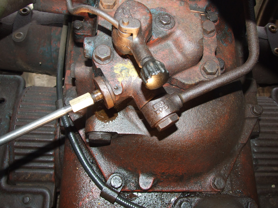

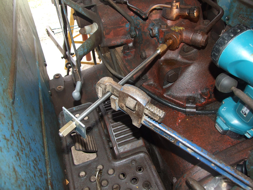

Uploading photos, I used to use Photobucket, but as they now want $399 subscription to upload photos to a forum, I've moved to Postimages, not too difficult, look about on google for a post from a guy on the Jaguar forum who explains it. Search uploading photos from Postimages to a forum. Takes a few hours for the password to become active.
Back to tractors, I made up a slide hammer to free up the auxiliary services spool valve. It was in all the time.

Anybody know what the 1/2 inch bolt, above the black flow control knob in the top two photos is for ?
Posts: 2559
Re: Three point linkage stuck up.
Nice looking Super Major you've got there. I think you want to remove that bolt when you remove the external service plate. I must say it seems the control valve might have stuck in the raising position, with the top off that should be immediately apparent.

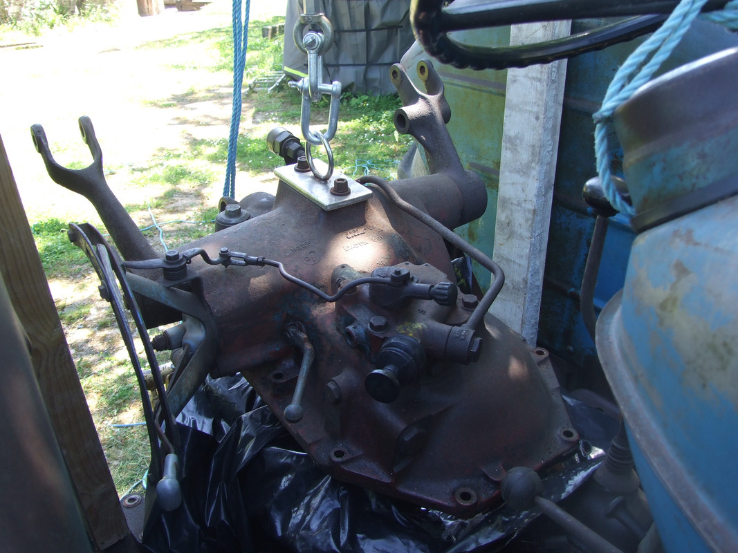

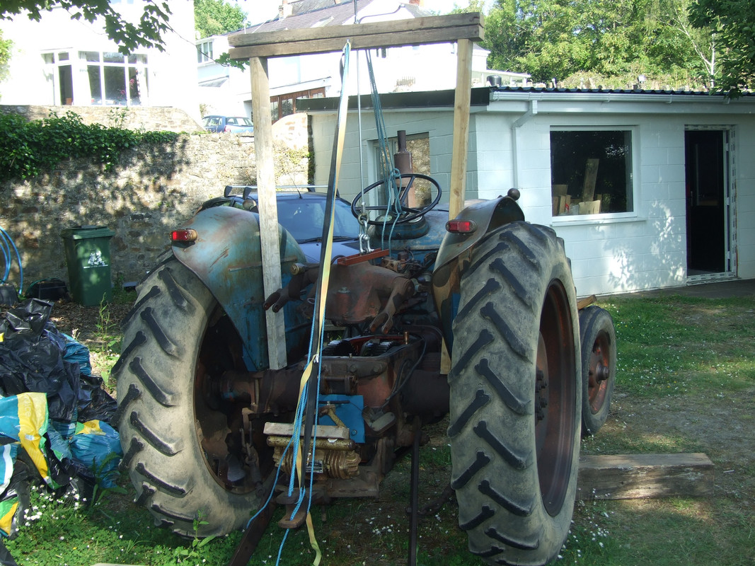

This was the first attempt using a straight lift using 4" y 2" off the axle trumpets. Didn't work, casting too heavy at the front.The piston and ram sit at the front,
Used a bit of channel to bring the lifting point forward,
The problem turned out to be a stuck spool valve. No threads on it to use a slide hammer, so used a brass drift.
All working well now.

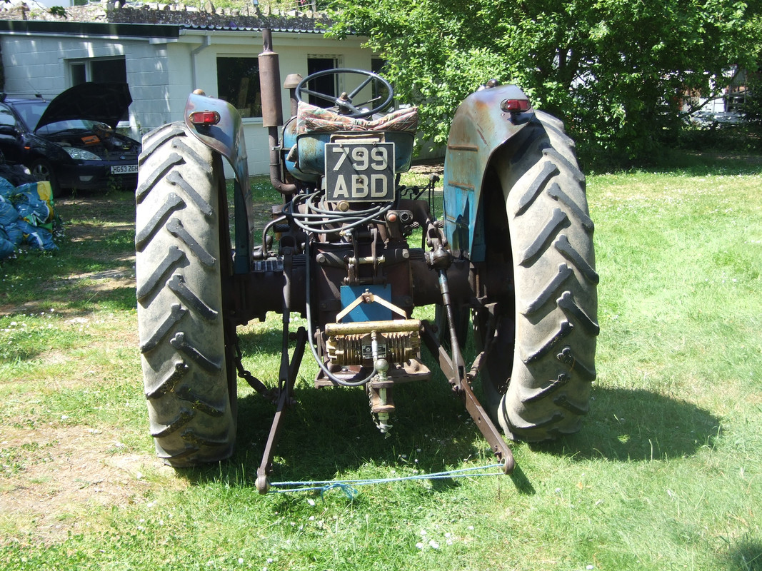

I'll end with a photo of the tractor with the arms dowm.
Posts: 2559
Glad you've fixed it, very nice Major you've got there, looking pretty original. Your LH lift arm is a rare pick-up hitch type, not many of these around now. The exhaust also looks like a factory fitted type (not the spare type that is very common from repro companies as well as true Ford ones), but the earlier Power Major type as the upper pipe is on the short side for a Super Major with the seat being that wee bit higher.
