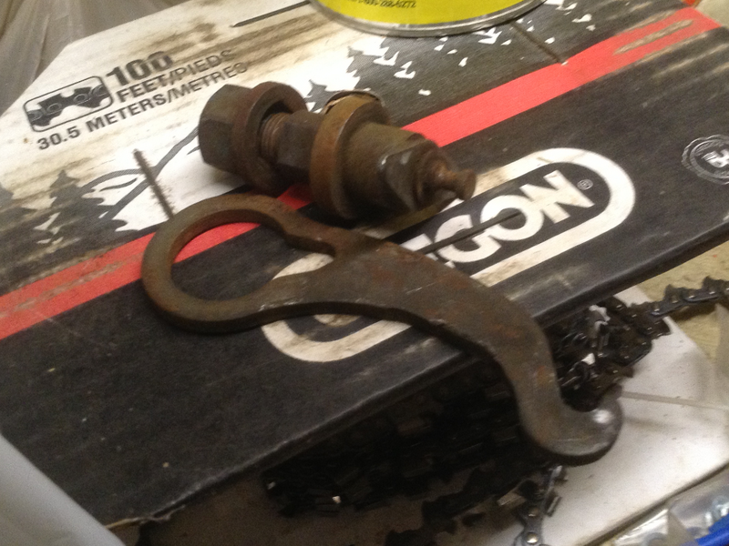

I cleaned things up, polished and lightly greased moving parts. Seems to return better but I'm not 100% confident.
Maybe I need to get new brake parts. I wish I took some pictures but didn't want to bring ipad out in the rain.

[url=https://postimages.org/]Image
Posts: 2557
Re: Brake cable question
I would try cycling the brakes a bit, as it could just be a tight spot. If that doesn't work give everything a good clean and inspect it before assembling it again. The bits in the pic look fine.
