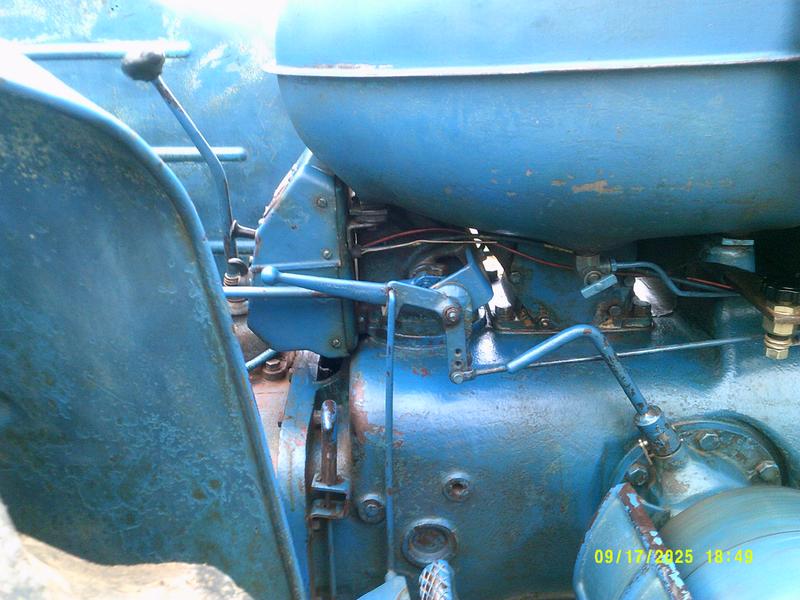

It was a switch, not a solenoid as there's no separate coil and electric operating mechanism, just a heavy duty switch (Lucas 76423, sorry for the error, 76427 was used on E27N's). The cable between the switch and dash was like the choke cable but with a knob marked appropriately, either a single initial as in the manual or fully spelled out (the choke will tell you what it should be). The ignition switch sounds totally wrong. It was a Ford made part, with the key being on-off only, and on is 45 degrees anticlockwise; the light switch is off, anticlockwise for side onlt, clockwise for dipped and full headlights on separate detents. Completely metal part, modern repro versions are a huge dissappointment in quality in comparison. Sounds like a good plan to me, there never were gauge lights, but a handy extra if you happen to be in the dark. Good to contact distributor experts, I'm not so can't help much there, see what they say. A service might sort the issue, I'll post the instructions for that:
Points should be at 0.014"-0.016". Timing before 1238809 was 9º BTDC for petrol and 14º BTDC for TVO. As you have a different distributor it's possible that neither setting will be ok.
As for the governor, it's oiled by the engine oil, should have around 1/6 pint in it. As for the shaft, better to remove it, it'll just pull out after removing a screw on its RHS, then squirt engine oil in with an oil can.

Also, when the timing mark on the front cover lines up with the mark on the crankshaft pulley, what ° is the motor set at?
It that at TDC - 0°,
8° BTDC, or ? 🤔
So far I have learned that the curve map, of even the ORIGINAL Lucas 40275, is completely and totally wrong for modern gasoline.
Still in talks with the rebuilder. Hoping to learn as much as I can. I explained to him, and now you as well, that I know very little about distributors.
I can replace consumables and set the breaker gap, but that's about it...
Posts: 2561
Re: Timing cover AND other questions. 1952 Gas Major
Not really sure, there used to be a separate additive to add to unleaded petrol for old engines, but we've barely used it on our petrol engines and they're fine, but can't really answer. The timing pointer marks the setting required, but that might be any of the possible settings I mentioned or even 29ºBTDC if a diesel one is fitted. See if you can find a part number on it. Remember these engines are not meant to run any faster than 1600 rpm.
