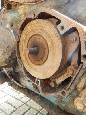

The diff shaft in the middle does not move.
It did go in and out before. But after taking the brake off and putting some bolts back in as in the picture (I hope I can attach this picture), it doesn't move.

Current state....
Posts: 2559
Re: Super major diff locked on.
I think you'll need to dismantle further and check all the diff lock bits.

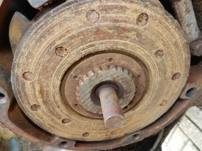

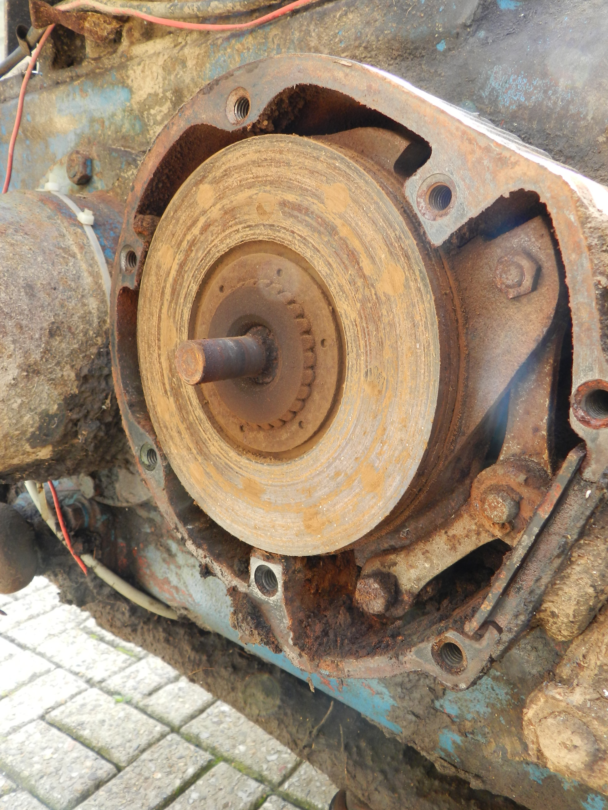

In the last few days i have removed the other brake and housing. Here's a photo hopefully....
As luck would have it, I can't shift this one either!
It seems as solidly set in position as the problem side.
I have thought about using heat, but with oil around the bearings etc I've not resorted to that yet.
Here's a photo from the top of the diff lock side.
Gives a better view of how far the diff lock pin is protruding. ( I'll have to go out later and see exactly how far it's protruding).
It did spring in and out fine before I took the brake to pieces, although obviously never disengaged the diff lock. After I dismantled the brake and put some bolts back into the surround and tried pushing it in, it no longer sprung back out.
Anyhow, if I fail to pull out either pinion shaft, the only option left is to remove the large top cover.
At least then, things will be clear.

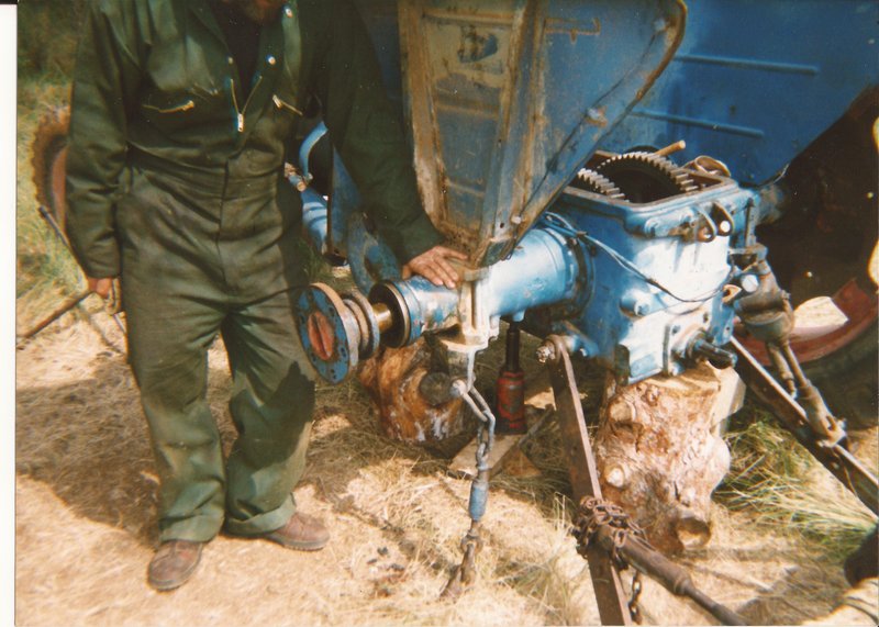

Here are some pics of Billy, a bit different but basically the same.

I like your tree stump supports in those pictures.
I've got a couple of them stuck under the tractor right now as well.
