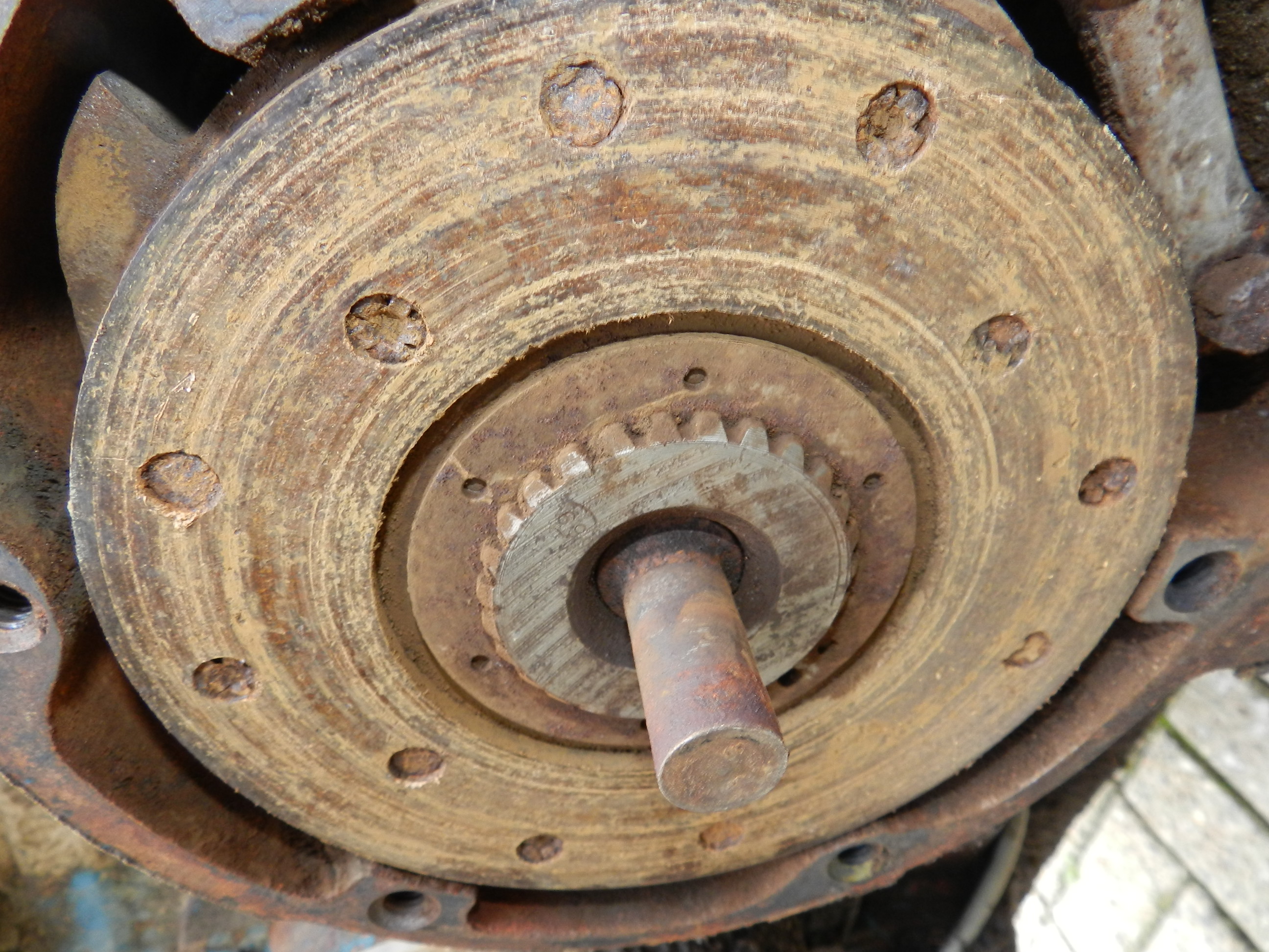

Nickm
Posts: 35
Joined: Fri Apr 16, 2021 3:53 pm
Re: Super major diff locked on.
Post by Nickm »
The diff shaft in the middle does not move.
It did go in and out before. But after taking the brake off and putting some bolts back in as in the picture (I hope I can attach this picture), it doesn't move.

I think you'll need to dismantle further and check all the diff lock bits.
Posts: 817
The shaft is sitting to deep. The nut at the end must be missing.

I think the spring that brings the operating rod back out is broken, try and see if you can pull out the operating rod.
The push rod should protrude about 1.3 inches or 33mm from the end of the bull pinion shaft when the diff lock is disengaged, if it is less than this then the lock is stuck engaged as you report. This could be due to the rod being seized in the bull pinion shaft, there is a strong return spring just in the end of the pinion shaft that returns the rod when the pedal is released, and an "O" ring seals the rod to pinion shaft joint. Give the rod a good soaking with penetrating oil where it enters the pinion shaft, some might get past the O ring, gently tap the pinion shaft with a copper hammer to shake up any corrosion between the rod and pinion shaft and apply more penetrating oil.
After letting the penetrating oil work put a pair of mole grips on the end of the rod and gently try to turn the rod in one direction then back, if it frees keep rocking in one direction then the other. If the rod is properly free it should be possible to continually rotate it, the construction allows this so it will not do any damage. If the rod frees to rotate but does not pop out try pulling on the mole grips whilst turning the rod back and forth. If the rod frees and pops out then that is where your issue is, you will need to get the bull pinion shaft out and it comes out complete with the bearing so the bearing outer race has to be free on the bearing housing casting so make sure everything is clean and soaked with penetrating oil. If the bull pinion shaft and bearing will still not withdraw you could try a heat gun on the bearing housing. Once the bull pinion shaft is out remove the split pin and castellated nut, withdraw the push rod, clean everything up with fine emery cloth and wash clean with petrol, fit a new O ring, grease the rod up and reassemble the rod in the pinion shaft and set the castellated nut so that the rod protrusion from the end of the pinion shaft is 33mm, then fit a new split pin. Reassemble the unit of coupling, push rod and pinion shaft and bearing into the housing.
If all the above does not let the rod out then the diff lock coupling is stuck either IN the left hand differential pinion gear female or ON the right hand bull pinion shaft male or possibly both, this could be due to oil glaze or corrosion or burring on the machined surfaces.
If the rod is free to rotate and the castellated nut had come off then you would be able to completely withdraw the rod from the bull pinion shaft, so it is unlikely that the nut will have come off.
If the problem IS due to the diff lock coupling being stuck in the left side diff pinion then you will need to remove the left hand brake assembly and bull pinion shaft, and insert a suitable long drift into the left hand diff pinion to contact the castellated nut or coupling and gently tap the whole right hand assembly of pushrod, coupling, bull pinion shaft and bearing out, be careful!
Hopefully your issue will be a stuck push rod in the bull pinion shaft.

In the last few days i have removed the other brake and housing. Here's a photo hopefully....
As luck would have it, I can't shift this one either!
It seems as solidly set in position as the problem side.
I have thought about using heat, but with oil around the bearings etc I've not resorted to that yet.
Here's a photo from the top of the diff lock side.
Gives a better view of how far the diff lock pin is protruding. ( I'll have to go out later and see exactly how far it's protruding).
It did spring in and out fine before I took the brake to pieces, although obviously never disengaged the diff lock. After I dismantled the brake and put some bolts back into the surround and tried pushing it in, it no longer sprung back out.
Anyhow, if I fail to pull out either pinion shaft, the only option left is to remove the large top cover.
At least then, things will be clear.

The diff push pin is sticking out by only 23 mm.
Posts: 2501
I recommend you remove the top cover and try removing the bull pinions and carriers, this means you'll need to loosen the axle shafts (remember the LH thread and to loosen the seal casings) and move the final reduction gears out the way first. You should be able to get them out then.
