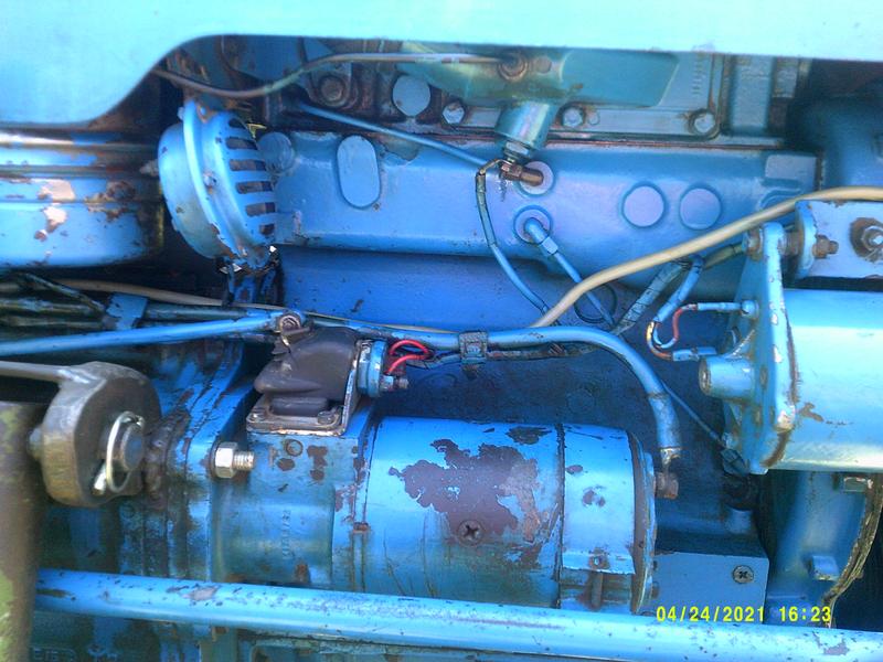

By the way the engine number might be CKN | 372. I will attach a picture. Where do i find the serial? I thought it would be on the bell housing by the timing window, but did not find it.
https://photobucket.com/share/bad442cf- ... d89e119f1b
This is how she ran before the previous owner removed the pump because of leakage.
https://photobucket.com/share/58584770- ... 70d8453718
Re: 1957 Dexta Fuel Pump issue
That number is on all Dexta's, the serial number is on the bell housing flange just in front of the timing inspection cover, the engine number is on the block just behind the water inlet, below the exhaust manifold. Casting codes are also worth finding. That might have actually been dirt. Sounds like your primer is leaking, it's not meant to drip like that. You can look at the primer if you want but a good atomiser (from engine 1409432) should keep that from getting in the engine (earlier engines do require the primer to be leak-proof). I can't help you with the atomiser without the engine number for there are four, and if your tractor is as old as it seems to be it could be a tricky part to find. The first one was used till 1404118, with a banjo connection, the second was used till 1409432, and was identical to the third except it didn't yet have a spring loaded ball valve to prevent leakage, the third (E414-CL-9) ran till the end except in Britain and perhaps other countries where regulations prevent the use of excess fuel when running, where from 09B-700977 a tap fitted atomiser (E761-CL-9) replaced the previous types, this last one is the only one made today.

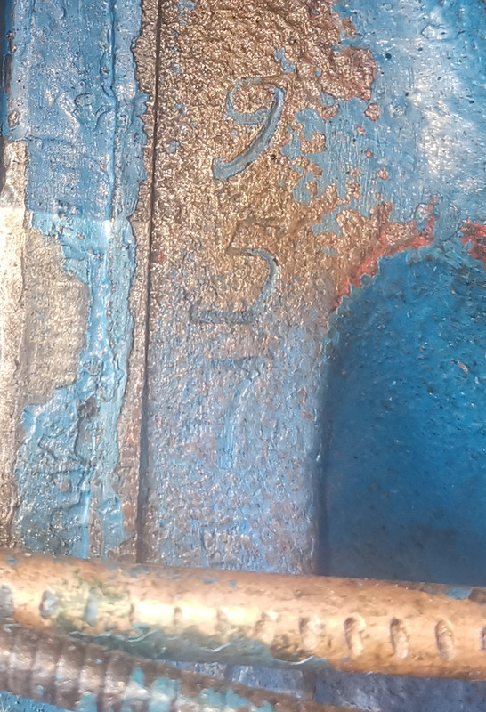

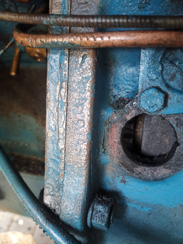

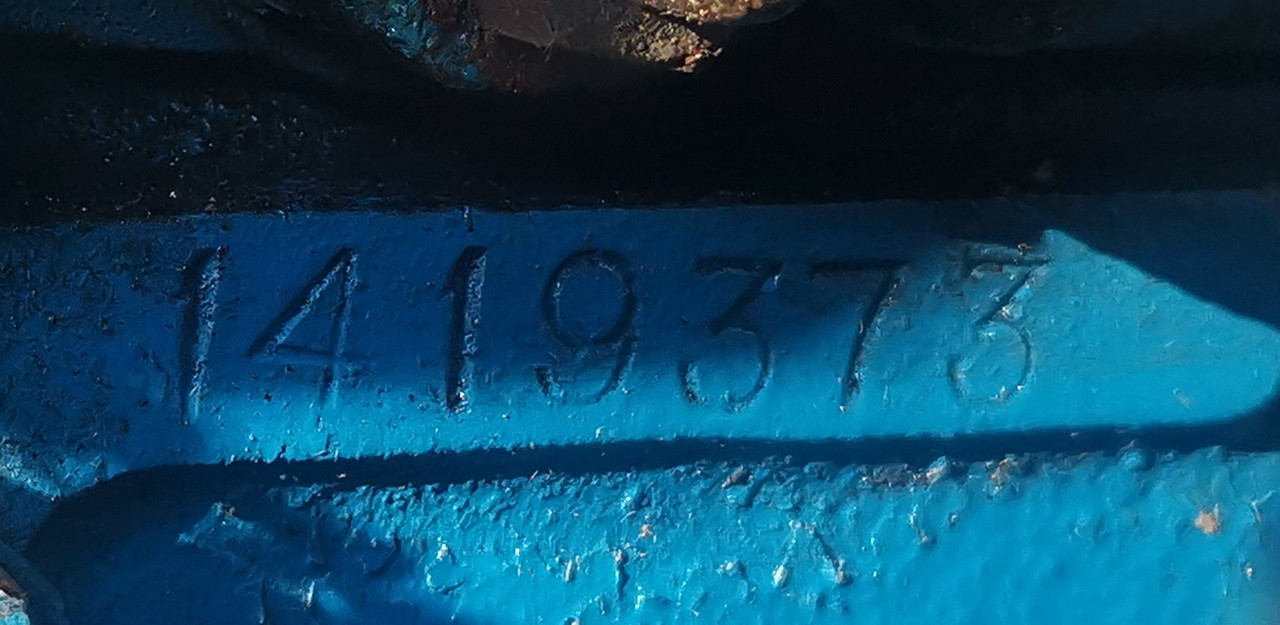

I think I found the numbers.
957E1 as best I can tell on the bell housing. ( i looked it up... does this mean its the first one ever made?) That would be pretty crazy!
For the motor it looks like 1419373
Cheers.
I doubt it'll be the first one, probably a number closer to the engine number, the first one would have been 957E-0001. If your engine is 1419373 that points at around October 58, and will probably have E414-CL-9 in the manifold. The link is for E761-CL-9, the only one available today. Try putting the atomiser on the pipe but off the manifold and see if the ball valve keeps the leak from pouring diesel into the manifold. If it doesn't look in the atomiser to see that the ball and spring are there and that the ball seats nicely on the atomiser. E761-CL-9 will fit perfectly, it's only engines before 1404118 that are moe difficult, in that case it would need pipe E67-JA-9 in place of the original E34-JA-9. Here's a pic of Davie, with E414-CL-9 and E67-JA-9. I suspect yours will look the same.

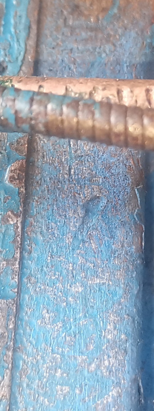

Trying again to embed pictures. hopes it works. I can't get the E to show, but its right behind the fuel line and shutoff cable. I am posting the above the line and below the line pics. You tell me what it means..
Motornumber
Serial part one:
Serial part two:
Neither above nor below the one are there any indentations to be felt.
The year is clear I would say.
Probably someone swapped the engine at some point.
Pics worked fine. More wire brushing is needed on the serial number, I read 957E-188xx which ties in with the engine.

Sandy, you are correct, i suspect you hear that alot on this forum 8)
I will add the picture of the complete number at the bottom.

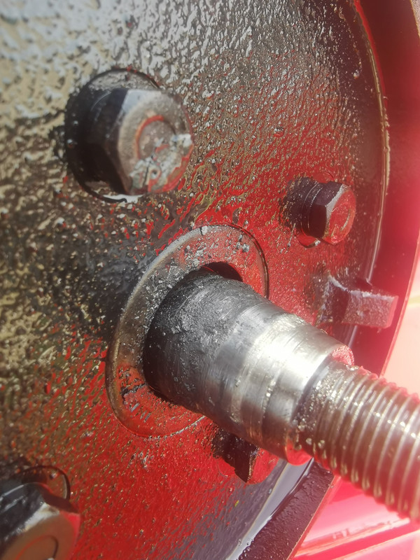

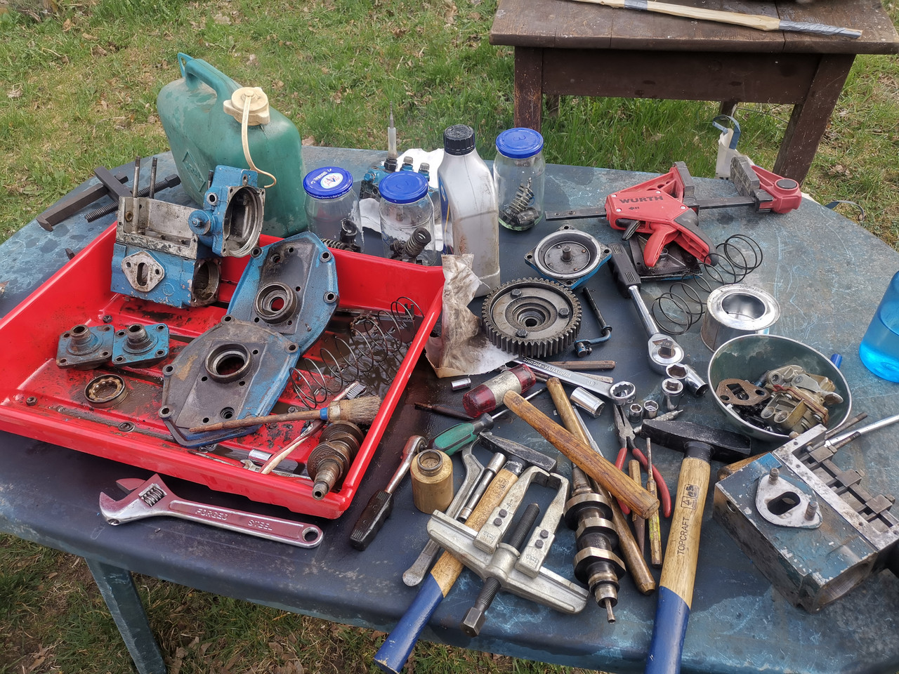

Ok Guys in case you are interested, this was a surprising turn of events. I started by checking the timing because i felt like i should, and sure enough spill mark was perfect for the second cylinder, wierd. Never mind set the spill to cylinder one and pulled the pump out.
Used a puller and A LOT of force to get the gear of the pump. And what do i find: Major Mahem.
When pulling the lift pump i realized what had happened. The new injector pump came without the studs to attach the lift pump. Not knowing that i needed studs i ordered the screws used for attatching the lift pump. The lady at petrol tractors checked and shipped me fitting bolts. Well turns out they were too long. So what endet up happening, the cam hits the screw (no mark on the cam by the way) and sheared he key on the drive.
Fortunately (since i have doubles of most of these parts, i have another cam.
Everything else went smoothly except for the inner races. Those are such a tight fit, that i had to cut notches into them to be able to pull them off with the puller. I dont really see how you are expected to remove the inner races to add shims in case they are needed. I think we will warm up the races put them in place and pray we don't need to remove them. Do you guys have a trick?
I decided to go ahead an put all new plungers and pump elements in. Since we are mixing and matching the best parts of both pumps, there is no way we can get away without a full adjustment anyway so we might as well use the best parts we have. (still factory sealed).
@Sandy, you seem to have the ultimate reverence guide when it comes to parts and their numbers. Do you happen to know if the outer races of the bearings are available? The new bearings came with inners. The other thing that would be good to replace would be the timing adaptor that holds the pump gear, i think the old one might still be usable (just so) if we polish out some of the roughness, but i would much prefer having a fresh one that fits smoothly. Of course the key is also toast. Btw. If you prefer you could let me know where i can look this stuff up on my own. I don't want to be bothering you all the time with my questions.
Running into this problem was a blessing in disguise because the whole pump sump was full of rusty disgusting oil. There is no way this was an overhauled pump. It would have failed very soon either way.

As i see it the main risk to the pump while disassembling came from the dirt on the outside, wich is why we washed and rinsed over and over with clean diesel. Once things were clean we put the lower pump parts with wet diesel hands directly into clean marked jars, cap on. will store them in diesel until time comes to reuse the lower parts.
The sludge in the bottom of the wash pan, is all from inside the cambox. It was hideous. The old Cam was pitted like crazy, there were all manner of rings and run-in spots on it. No wonder we had so much slack in the drive. Once the springs were gone, we could tell even better what miserable shape the insides were in.
The head unit with the delivery valves is still sealed. Wont touch that until i start reassembly in a clean place.
I agree new bearings would be nice, just not sure whether they are avalyble and what to search for.
On the other hand, with an end drift of half a millimeter, i wonder how imprortant it is to have matched pairs.
The oil seal on the mounting plate side, is available, which is nice. The other side, i own 3 brand new ones, from the previous owner.
The workshop manual is very helpful (i have two versions), but they do assume that you know what you are seeing alot. Many times the descriptions are detailed, but a picture here or there would be helpful.
Or a close-up of the special tools that they assume you just have laying around. Is there actually any collection of those old tools? If so it would be awesome if we could do like library of tools where they can be borrowed, so that the community can use them.
If you can point me to any of the item numbers of the missing parts, i would be greatful.
Pleased to see you were careful. The pumps do get dirty if left unused for a while, but that looks like more that usual. Many parts you can get from https://injectionpumps.co.uk/, there are other suppliers too but I haven't seen what they have. Bearings are available, A20 type. Glad the spare camshaft is good. Did any shims come off either camshaft? What numbers are there on the pump inspection covers? The Dexta had the SPE 3A 60S 402 and SPE 3A 60S 593, the difference being in the governor (GPD90A31 for the 402, GPD90A63 for the 593). There are two governor springs, 502E-993120 (marked red, Simms 87130) and 957E-993120 (haven't any hard evidence but I believe marked yellow, Simms 24172, the others are E1ADDN-993120, unmarked, Simms 22316, and 510E-993120, marked blue, Simms 89633). 957E-993120 is listed as Germany only. You say you have two versions of the manual, I assume one is Stefan's one I posted the link to, is the other one the I&T one? The special tools were generally only at dealers, the vast majority made by VL Churchill who I believe are still around. Can't be sure if you're missing parts, it looks like everything is there to me but would need more pics. Parts books are around on the FFCN and elsewhere but you might well still struggle to know if you have everything or not for very little can be found by Ford part nos these days in injection parts.
