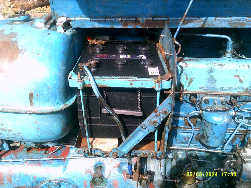

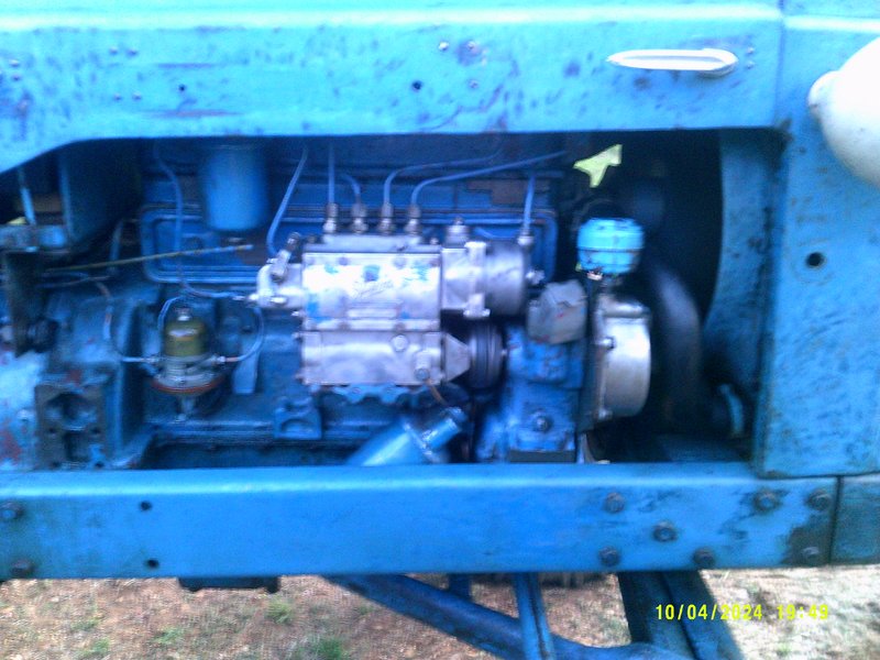

More pics as requested
<a href="https://postimg.cc/nCT2V40y" target="_blank"><img src="https://i.postimg.cc/nCT2V40y/20250915-085309.jpg" alt="20250915-085309"/></a>
I have ordered new 3pl ball ends for the fordson and new mount pins for the slasher and will soon be ordering new injector rubber seals. It's very dry here ATM so the extra dust on the engine makes it look worse than it is.
Old tractors,trucks and amateur radio
Posts: 2392
Re: Thank you. FSM Diesel
Looks nice. I see you have a raised PTO like so many Oz Major's. Sounds like you'll need the injector rubbers too, when you get to that job make sure the slots in the head are clean, including the drain hole that is meant to avoid them leaking, then make sure you pull the rubbers out the way once the injectors are in before they're tightened down to ensure they don't leak. Don't be too bothered if they do for a few hours, they need time to settle in. I see other jobs like a new starter rubber boot, getting a breather, getting the rubbers for the rest-o-ride seat or finding the correct Yuba exhaust, you also seem to have an alternator. A good clean is always worth doing too.

It was spotless a week ago so pointless doing it again. This is a work horse not a show pony for club events. I am pulling 1/2 inch of dirt out of the air cleaner after 7 hours of slashing. The idea of fitting new injector rubbers is to keep the oil on the inside, other than that I wouldnt bother. The rubber boot on the starter is superfluous. I blow it out with compressed air from time to time(it lives under cover so no water ingress) A Yuba exhaust????? Why?. Rubbers on the seat???????? Thats why I have an old pillow on there.
What is this breather that you speak of? Do you mean the pre-cleaner or the crank case breather that someone has plumbed into the air cleaner? That is the one that I just replaced with a length of garden hose that I found in the rubbish pile?
As I mentioned earlier I couldnt care less about "concourse" or even originality for that matter. The alternator charges the battery. That is its only job. As long as it does that I am happy.
Posts: 2392
That's exactly my point. A tractor that does nothing won't really mind dirt but one that works hard must be as clean as possible, dirt will only cause problems. Having said that I'm glad we don't have that much dust, you'll be getting through several gallons of oil in the air filter quicker than in the engine. The starter rubber boot is a lot more important than it might seem, if dirt gets into the bendix it will start to jam up causing big problems, then also affecting the bell housing if not taken care of. The starter switch will also suffer. The Yuba exhaust (as I understand it, I've never been there but other members on here have commented on this) was a legal requirement for the tractor to be allowed to run at all in Oz, and I'm not sure but suspect that such regulation has only become even more strict. You have a rest-o-ride seat, not a std DeLuxe seat, this has two round rubber springs (can be found new) that give an early form of suspension seat, as you'll see in this pic:
https://www.facebook.com/photo/?fbid=11 ... 9737914408
You're also missing the spring adjuster and link but the link can be made quite easily. These seats are quite rare as they were optional, and tend to be really expensive. I don't think I would like them but as I've not been able to try one for real I can't say. I do find poor coshioning in the std DeLuxe seat very hard going, much worse than the original Major seat E1ADKN-400 with its large rubber bung.
The breather system is as follows: an oil bath breather mounted on the timing cover (yours is missing) filters air into the crankcase, it's then sucked out through the rocker cover through a pipe connection to the air filter as you can see here:
Not having it like this will cause issues, some of these can be serious with dirt getting into the engine.
As for the electrics it's all fine till things go wrong, then unless you have some wiring diagram of the conversion you'll be struggling to fix things, as you'll be having to make that diagram up on the spot. That's why the original setup is much easier, as then you have all the diagrams and repair details in one manual, also the original setup is quite good enough for the job it has to do.
It is your tractor, and your decision on what happens but there are some things that can go wrong if not taken care of suitably.
