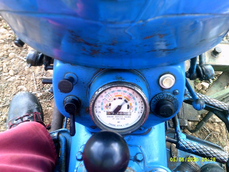

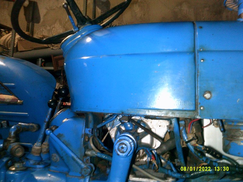

I bought it with a modern starter installed, so there is no classic starter lever. I’m using a kind of key ignition. I can send a photo tomorrow to show you what it looks like.
Posts: 2559
Re: Not original starter
The usual location is on the bell housing flange just in front of the timing inspection cover (LH side). Quite keen to see what you have in the dash, many people don't know about details and in the case of the ignition switch might fit a new modern one in place of the light switch, risking water entry. While Dexta's before 09A-315817N are correct with the combined switch in that location if there is risk of water entry it's worth covering the key apperture to prevent that, or if considered worth doing following the Ford instructions which call for the later setup to be fitted. Major's don't have this issue. The loader is an extra, there's no idication of the tractor's age from it, although it does seem likely that it was fitted when it was new. (but not more than that)

The dash looks badly wrong, it should look like Davie's one:

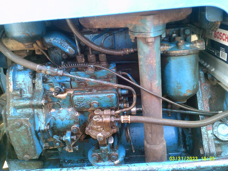

Why is there such a big difference between your picture of the fuel system and mine? I’m trying to figure out what might have been added or modified — it’s quite difficult to restore the original Dexta accurately.
Another issue I’m facing is that the engine is hard to start. The battery is new (90Ah) and always fully charged, but it still struggles to crank.
What’s the correct procedure to troubleshoot a hard-start situation?
I also read that behind the metal cover (marked in yellow), there are supposed to be alignment marks. Should I check those?
I’ve attached some photos in case someone can spot anything unusual.
Posts: 2559
The real difference is the injector pump which changed to a minimec at 09B-710530, the first Super Dexta, engine 1600001. Dexta's had it from engine 1530251. The only other major part to be different is the intake manifold, fitted with a butterfly valve before 09B-710530 and not after. From 09C-913383 further changes were made to the injector pump, marked P4696 instead of P4588, only on Super Dexta's, and all internal, including new injector nozzles. Throttle linkages and fuel pipes are all different in the two kinds of system. The lift pump and fuel filter are unchanged, except that very early tractors had a second completely interchangeable type made by Tecalemit which lost favour on later tractors next to the commoner AC type, with two variations. Your lift pump is wrong, and the governor pipe looks a bit doubtful too. As for timing you remove that cover and open the cover on the bell housing behind the serial number and check that when spill shows in the bell housing the pump marks are lined up too, no. 1 cylinder on compression. I wouldn't expect it to need adjustment, but if it does you might want to check that the pump's mark is accurate, but there's more work in that as you need to do spill timing on the no. 1 pump element. They were never great starters, they are after all indirect injection, which doesn't lend itself to quick starting. Your life will be made easier by using the primer and heater, although I don't know if you still have them, the heater button is certainly missing.

I’d really appreciate it if you could help me put together a list of the parts I need to order.
From what I understand, I’ll need a new lift pump — do I also need to replace the diaphragm?
I’ve already bought the primer and heater; just need to find some time to install them.
Thanks a lot for your help!
Posts: 2559
For originality you do need a lift pump, but it should be a genuine AC YE pump, but I suspect functionally your current one will be ok, so not an urgent job (unless its diaphragm is porous in which case it needs replacing, new ones are available). As for the governor diaphragm it only needs replacing if it's in trouble (leaking and allowing the engine to race ot run away completely), a bit of petroleum jelly will help it survive for longer as these are leather and doo become porous if not treated suitably. Unfortunately what you've bought is the MF Thermostart setup, not the Dexta one. The Dexta heater is just a heater screwed into the bottom of the intake manifold, with a separate atomiser screwed into the side of the manifold. There are three atomisers but from 09B-700977 all tractors in Britain were only allowed to use the final one, still available. The first one only lasted till 58 and is considerably different, the second one remained in use in places where the British legislation that brought about the third type didn't apply. Neither of these is available for the same reason. The fuel tap has a primer pump attached to it and is pumped manually when starting.
