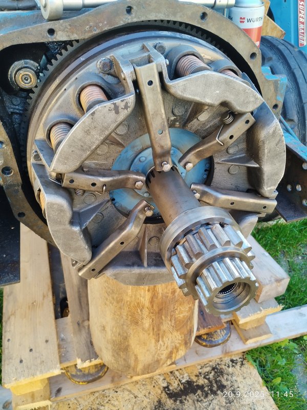

Hey guys, so today I finally separated the engine from the transmission. Unfortunately, I won't be able to do much more this weekend... So I'll continue again next weekend. Aleš

Just an observation, have you got any form of wedges each side between the front axle and the engine frame?

Re: PTO problem? Gearbox noise Super major 1963
A wooden wedge or similar each side of the engine between the bolster and the front axle to stop the engine tipping over sideways while it's not attached to the gearbox.
If it works, leave it alone.
That all looks pretty good, as Rob and I said you need some wedges between the front axle beam and front casting to hold it steady. Clutch looks good, a good clean in the bell housing is worth doing before taking the gearbox out, also, you don't need the PTO casting out before removing the engine, you will for the gearbox. You also need to remove the selector plate, belt pulley cover and also the high low selector link, an awkward job, before the gearbox comes off.

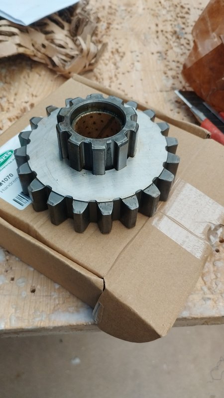

Hi guys, so today I took out the gearbox, but I haven't completely dismantled it yet. I would say that the handbrake mechanism is destroyed and the gear wheel doesn't look good either... But the good news is that I found a brand new gear wheel for about €45 on the website where I order spare parts. I have to buy it because it's not even on the transmission I recently bought. The rods on which the handbrake plates are mounted are also bent, and one even has a crack. Well, I found more cracks... Overall, it seems to me that the gearbox that is currently in the tractor looks much worse than the gearbox I recently bought and plan to install in the tractor. I have one question for you: under one gear wheel, there is a lock nut that was not properly tightened on either gearbox. Is there a special wrench, or is this nut easy to tighten? I am attaching some photos here, and tomorrow I will take more detailed pictures. Before the gear wheel for the handbrake arrives, I will work on the clutch, for which I have already received all the parts, including the bearings. Well, originally I just wanted to fix a few things on the tractor, and now it looks like everything on the tractor will be fixed in a moment :D I have already completely repaired the front axle, including all bearings and seals, and the entire steering system. I also replaced the bearings on the rear axle, including the seals, and replaced all the hydraulic seals, including the hydraulic piston seal... And I only wanted to do a few repairs :D Well, hopefully there will be time for the engine in the winter, and hopefully I'll completely repaint it next year. My girlfriend is already complaining that I spend more time with my father and the tractor than with her, so I'll have to take a break from repairing my Major :D I would appreciate any advice, especially regarding the nut in the transmission. Thanks, Aleš
And before I forget, I wanted to say that visually, the bearings don't look too bad, at least the ones I've seen so far. Over the weekend, I hope to take apart the original transmission and hopefully find something. I think most of the metal fragments were from the handbrake... Well, I hope that when I replace the transmission and turn on the PTO, I won't hear the same sound :D but on the other hand, my dad and I will have something to do again :D
Ouch! I think you'll need to clean everything really well, it's possible that the dirt from the handbrake failure has ruined other parts, anyway take the best parts and you'll be better off, a new reverse idler sounds good, to go with new plates. It sounds like the common issue of leaving the handbrake on, which in this case appears to have been forced to the point of breaking the splines, an unusual thing as often what happens is that the gearbox is locked tight until it comes out. Cracks are not good, try to get the better parts and see which of those are still cracked. Looks like you've ended up giving it a fairly comprehensive overhaul, no bad thing. That nut should be at 100 lb ft torque, you'll need T.7030 or Tr/D 85-GA (same tool, but the numbering was changed in August 57), I recommend you remove that nut to check that the woodruff key in there isn't damaged and that the locking retainer tongue is too.

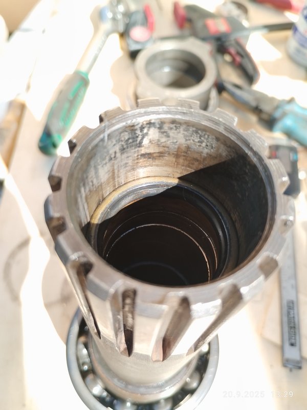

Post by Aleš63 »

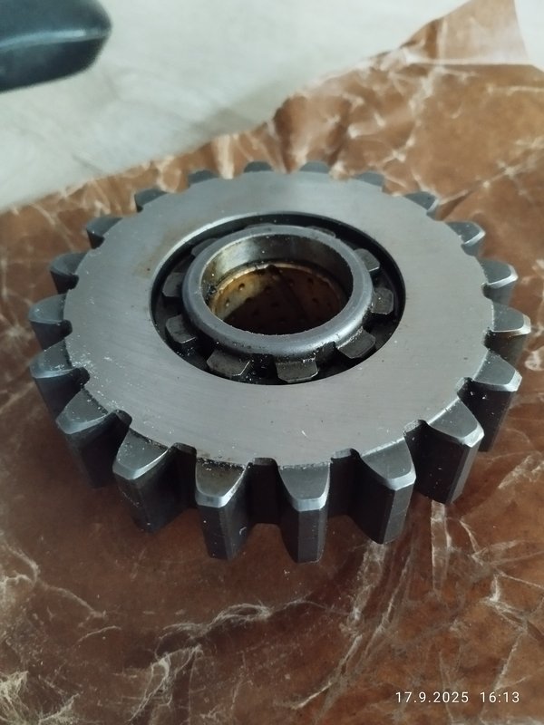

Hi, thanks a lot for the advice. I have a question. Today, while replacing the bearings for the housing, we pulled out the small shaft of the upper gear wheel. When we pulled out the shaft, the needle bearing rollers fell out, and I don't know what kind of bearing it is. Does anyone know the exact bearing number? I couldn't find it anywhere using the original number (81805001) in the catalog. Thank you very much for your advice. Aleš
You're best just to find any needle rollers you lost if you did. Can't help more than to say the part number is E1ADDN-7259B. Major's had bushes E1ADKN-7259 and Power Major's before 1545996 had needle rollers E1ADDN-7259. The part number you quote is the CNH one, not the original one.

Post by Aleš63 »
I meant exactly what was written on the bearing by the manufacturer. According to this number, nothing else can be found. Well, I'll have to take the bearings out today and quickly go buy new ones. Aleš
I did know what you wanted, but can't say it for I don't know it. If you post it once you find out then others needing it will know.

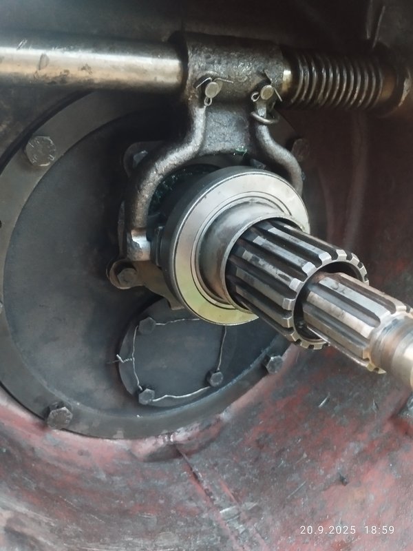

Hi guys, so today I adjusted the clutch and put it back on the tractor. Then we replaced all the seals on the transmission and put it back in the tractor. I have to say that putting the transmission back in the tractor took a lot of strength :D and the worst part was that the transmission housing is really tight, so it was really hard to get it in... At a certain point, it always got stuck, but now everything is in place. I managed to get completely new paper gaskets for the entire transmission housing, which I'm happy about. The handbrake gear arrived this week, so I replaced that gear as well, including the plates. All that's left is to reassemble the other components and see what kind of noises it makes when I start it up. I'll have to install the PTO housing next weekend because I still don't have the needle bearings, but otherwise I've replaced all the other seals and bearings. Aleš
That all sounds very successful, and the pics all look good too. Hope it all goes well.
